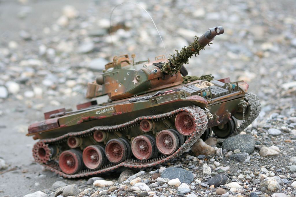

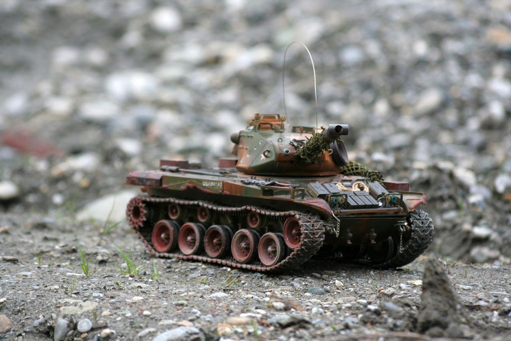

Here my last tank, no FPV now, but it's fully equipped with metal tracks and trasmission, IR combat unit and gyro stabilizers for turret.
and probably this is the one I choose for a C02 cannon prototype.

I've a fully upgraded Heng Long M41A3 Walker bulldog :
- metal tracks and sprocket (trasmission wheel)
- metal 5:1 trasmission system
- Clark tk22 electronics
- gyro stabilizer for vertical and horizontal cannon movement
- all standard electronic replaced with servos
In normal configuration it fires (with leaky OEM shooting system) 6mm 0.23 grams balls, stored into the turret and usually filled via hatch.
But in best conditions it reaches about 5/8 meters of distance. It's a shame, so... yes I need this power !!
